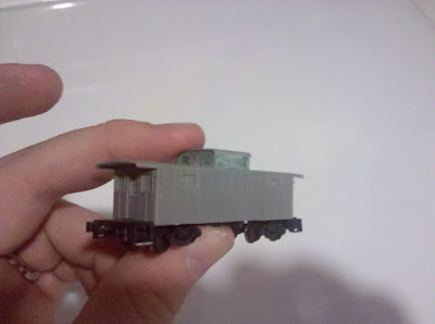

I like it Lee. Those things are B'more staples.
Personally, I've been working on what may shape up to be a true railwire-wide project...
A CR N8B.
I spent some time today getting Bryan's NE5 shell to settle down onto the frame, and am now working on patching the cupola.
For reference, here's what it'll look like when I'm done.
http://thecrhs.org/Images/CR-23575-at-Pittsfield-MA-on-51886
Now I need to track down a set of bay windows for it. I'm planning on using walthers ones, but... I have an email to send.

« Reply #6 on: December 19, 2009, 11:15:16 PM »
The Walthers ones are perfect for the job, but you have to track down the Conrail bay window specifically as that is the only decorated version they were used on.  Walthers has none, but they turn up on eBay every now and then.

« Reply #8 on: December 19, 2009, 11:30:44 PM »
Yeah, I have a pair, they're slightly clunky, but we'll see.
What are you using for grabs, btw?

« Reply #9 on: December 20, 2009, 10:01:35 AM »
Either .006" or .008" diameter stainless steel wire, whichever your preference is.  A length that will last you for a few years are available from Small-Parts at a reasonable price, either 30" or 60" if I remember correctly.
Forgot to mention - strip the super-thick layer of CR blue paint off the bays and repaint with the model, the detail isn't as clunky then.

« Reply #11 on: December 20, 2009, 04:18:48 PM »
Email Received Ed ....
The spare bays that I have are too big me thinks. Look at my SP C-30-6 and if you think you can use them, I should have a couple hanging around. You also may want to try Don Tichey for phospher-bronze wire. He does carry .008 and would be much cheaper than SS unless that is what you want to use.

Re: Snow Day
« Reply #12 on: December 20, 2009, 05:20:30 PM »
Shoot, those are too big.
It'd be the ones for the N7s that I'd need.
I'll try the Walthers ones. And thanks for the tip on the wire.
In other news, anyone know a good source for a stove pipe like that?
