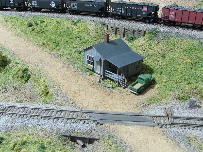

From my small 2'x4' layout. The dirt was rubbed through old stockings to end up with what was just about powder (this is N scale) After gluing I used more fine dirt from the "Weather it" kit, this was a different shade for contrast. Then even after all that I dry-brushed it various colors.
I'm not so good at scenery, probably why my layouts don't get far...

That's some of the nicest scenery I've seen.  Can't even tell it's N!
