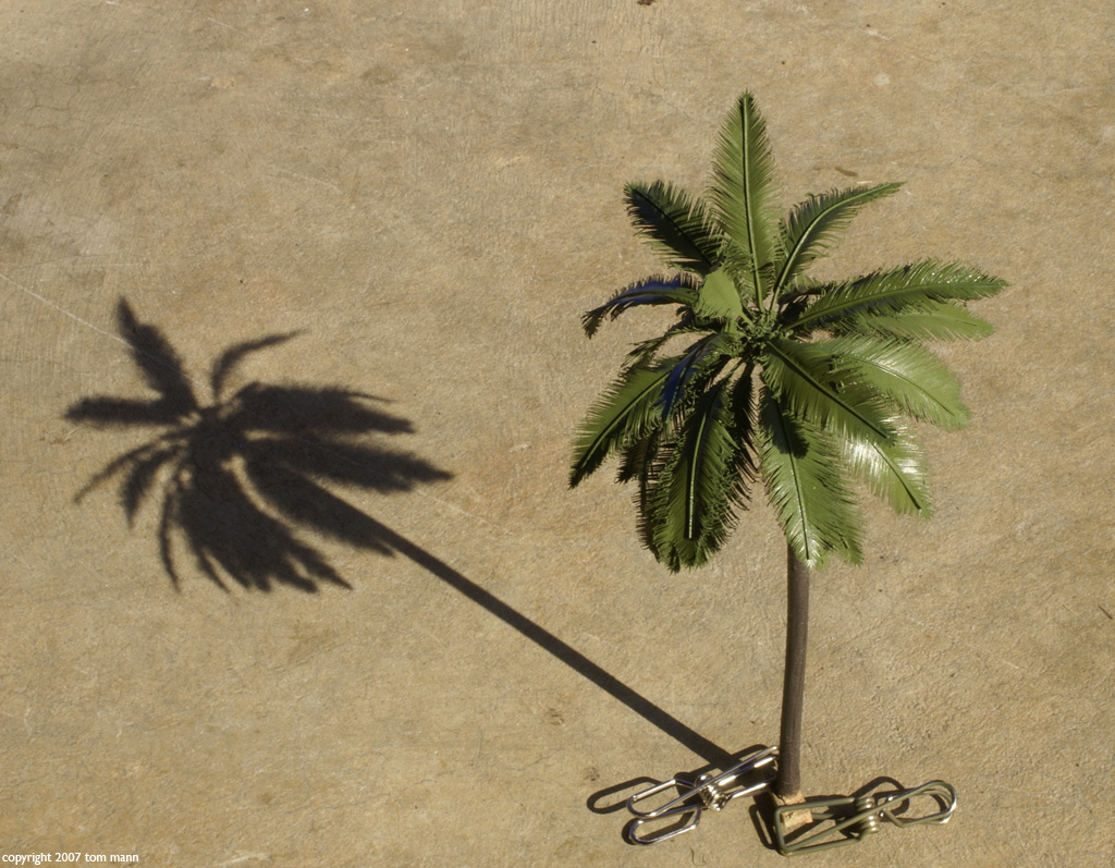

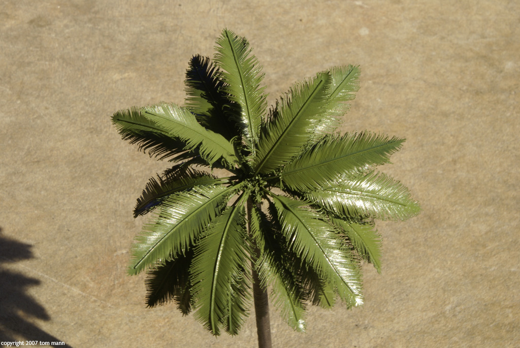

This is the coconut palm kit from Hart of the South.  What a neat looking tree and ingenious kit!  The one thing that I would add to the kit's directions is to wash the fronds after applying powder to make gluing easier.  I also had trouble getting the fronds to droop using the hair dryer technique.  Paint is a mix of reefer yellow and Avon blue for the fronds and roof brown and a black wash for the trunk.  The model is about 7" tall.

That's a neat looking palm, Tom, one of the best models of a palm tree I've seen. But 28 feet is a very small palm tree. That thing's more HO size. For O the whole tree should be larger, as least a foot high, or the trunk shorter for a dwarf variety. Just IMHO, but I do live in Florida and have two palm trees in my front yard.

To a Florida boy, that is a great looking palm tree. However, it looks like it lost all of it's nuts.
Is this a post-Andrew palm tree??

Gregg, I bought the kit a long time ago before I was in O scale...so I would probably buy a larger size today.  The beauty of it is that it doesn't take up a lot of room.

Oh guys, what about the coloring of the fronds and trunk?

How far do you want to go? Knowing your penchant for ultimate detail, the colors are quite good, but the fronds are too uniform in color. The very tips of each spike should fade to a yellowish tan, more on the lower fronds than the upper, with very little tan on the newest fronds.

Maybe not hours, but I may be able to achieve this blending effect with the airbrush for next time.  In fact, I may paint the fronds before installation to make this easier.

The tree looks good.  Try giving the fronds a wash of darker green...maybe something like Pullman green.  Here in Florida, the trunks are pale...either a pale concrete gray or a bleached-out khaki.  After you paint the trunk, give it a wash of brown.
Here in Florida the green colors are bright...but I am not so sure that looks right on a model.   Yours look good.
As a frond grows, it is rolled up so it looks like a spear, and shoots straight up from the top of the trunk.  As time goes on it unrolls and lies flat, then it continues to drop until it lies along the trunk.  As the fronds pass the horizontal they begin to die and turn tan.  The farther down, the more tan.  I use twine to represent the dead fronds on trees.  Bill
