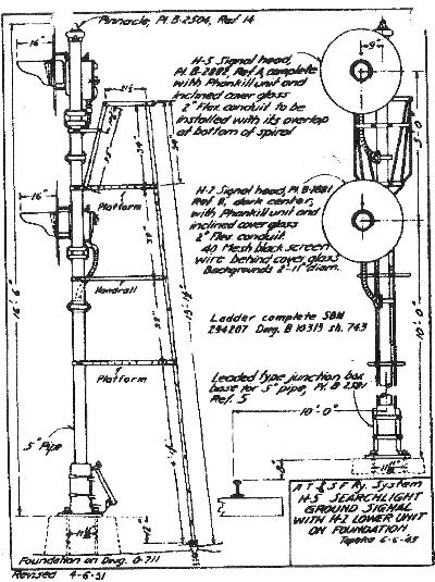

Arbomambo, the differences you see in pics can be explained. ATSF used two predominate arrangements:
When trackside, the target were to the left of the mast (when viewed from the front) and both targets where the same distance from the mast. When viewed from the side, both targets were in the same plane and were a few inches forward of the mast. ATSF predominately used the familiar Y-ladder and platforms on the trackside signals.
When installed between the tracks, the ATSF signal resembled the SP signal in that the targets were mounted in-line with the mast (when viewed from the front) and the upper target had a shorter bracket arm than the lower target. These signals almost always used the single angled ladder that curved up to the mast.
Hope that helps in clearing up the differences.
Regards
boB Knight

Bob,
thanks for the info....that helps!...since these will be trackside, I'll keep them offset, and keep the electrical cabinets oriented this way.!
~Bruce
