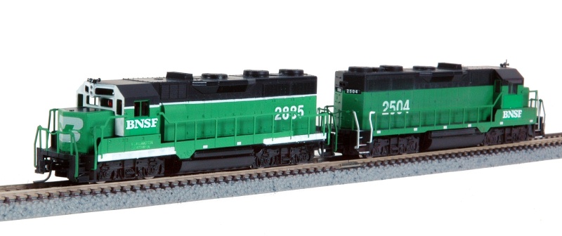

Playing with decals on a second GP35... trying to make the lead unit a whiteface by modifying the stock MTL scheme.
Not too bad, though a slightly smaller nose logo would be better.  BN nose logo is from an ED Models decal set.  BNSF cab lettering is from the Micro Scale HO BNSF patch set.  Hood numbers are from the MS N BNSF patch set.  White pin stripe is also from Micro Scale.

Mike, Robert made some BN decals for the GP39M. I think those would be a better choice. Talking about GP35s, I just received a H1. It looks great.

Up to 42 decals...
Still have to do the individual numbers in the numberboards, but I wanted to play with the weathering first.

Looks good, Mike. I see you added a lot of details to the engine.
