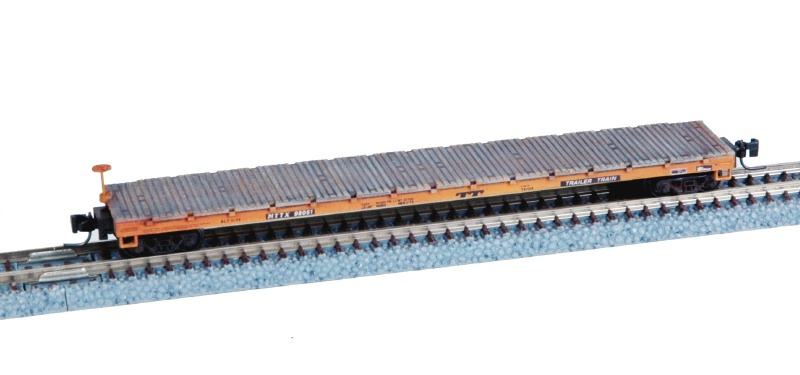

First car appears to be yellow, but well weathered.  I pulled out a TrailerTrain flat for this one.  Given the early scheme, I decided to distress the wood deck and weather the sides.

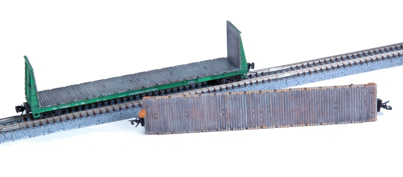

For the weathered decks, I start with a base coat of Pollyscale Milw Rd Gray.  Then layers of paint and chalks, sanded with a coarse emery board in between to make it look more like weathered wood grain and less like paint.  Here's a shot from above, along with the BN car which I'll cover farther back in the train:
And a little closer:

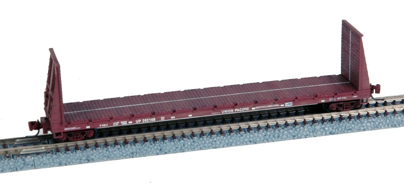

Second car back is brown, and has a white centerline stripe... not much to go on, but this UP car looks promising.  Deck appears to be in good condition on the prototype, so I left it fairly clean, just gave it the in-use look.

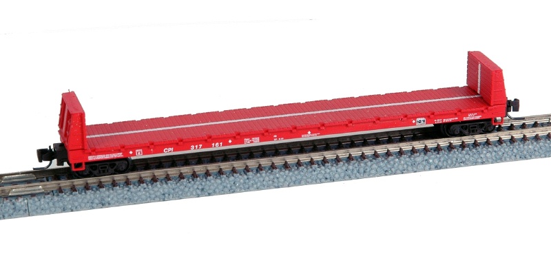

Third and Fourth cars are red and have lower bulkheads.  MTL released a pair of CP Rail bulkhead flats, so I used those.  I cut down the stock bulkheads and left them clean.  I removed the CP RAIL from the right side, and left the rest of the lettering in tact.  If I ever figure out what railroad these really were, I can change the reporting marks.  I was pretty sure the 1987 scheme was wrong, just don't know what's right so I modified it a little so it wasn't obviously wrong.
« Last Edit: February 02, 2009, 10:38:06 PM by Skibbe »

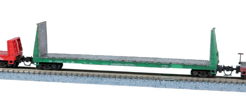

Next up is that green BN car.  MTL just released a standard flat in BN, the one with the generator loads.  I scavaged the bulkheads off another flat, matched the paint with some Pollyscale BN Green, and did the weathered deck treatment shown above.  I think I like this one best so far:

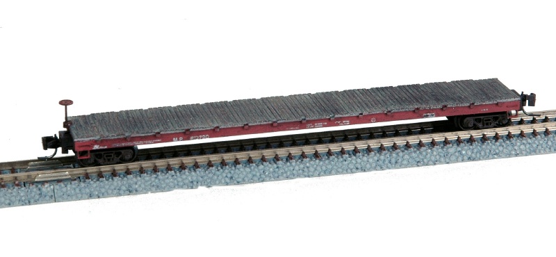

There appears to be space for another flat between the Green bulkhead and the last Yellow bulkhead.  So, I'm filling in with this MP flat from MTL.
Now I just need to come up with a yellow bulkhead flat... and then figure out what I'm going to do about modern tankcars and those Cryo-Trans reefers in back.  Some scratchbuilding may be in order.

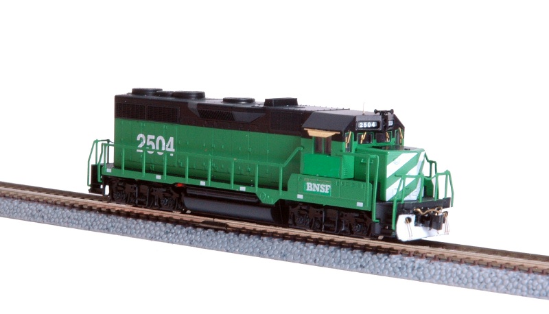

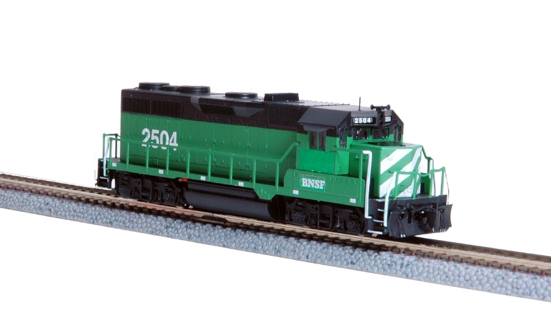

More lipstick on a pig.  BNSF "inspired" GP35.
Haven't found the right BNSF lettering for the cab subbase yet, thinking I need to check out the HO Microscale patch sheet.  This BNSF lettering is from a Robert Ray centerbeam kit and is too small but closest I could find in the stack today.
Etched parts from BLMA.  I built the pilot out, body mounted a shortened 905, and added a carved styrene plow.

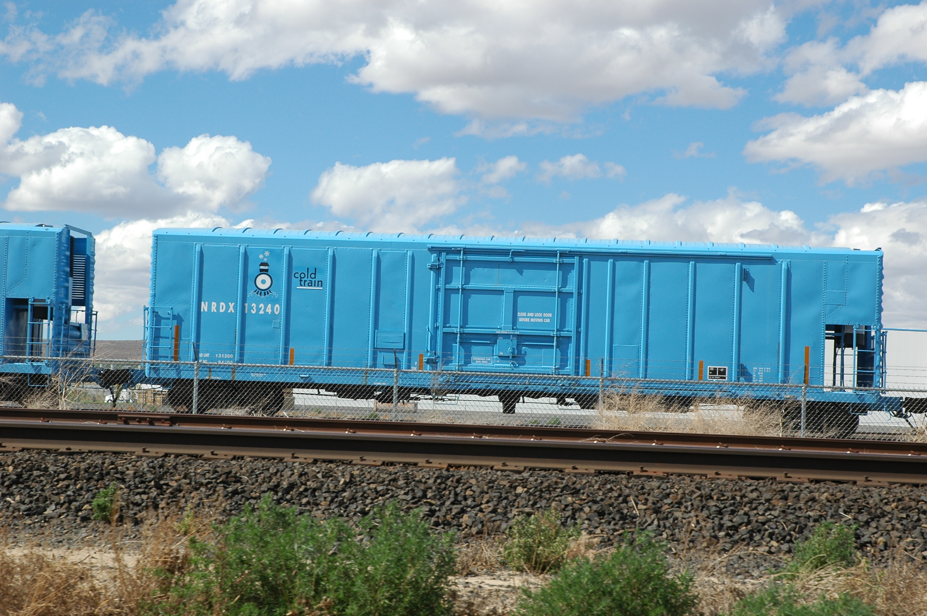

Cold Train car sitting in Quincy during last year's WA trip:
http://cgwrr.com/BNSF/DSC_0261.JPG
(Link to really large photo, so not embedding it in post...)
Looks pretty close to this so will need to find some decals:
