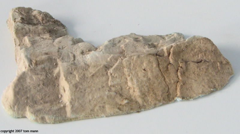

Well, this is my first rock  ;D
Nothing really special.  Just casted with white and then painted with a very thinned wash of titanium and raw umber.  I followed that up with a raw umber wash to bring out the detail in the crevices.  If I could do it over again, I would mix some paint in with the Hydrocal.

Looking great Tom!  They have a very "Mormon Rock" look to them and I love that...
http://www.railpictures.net/viewphoto.php?id=166939
Now all you need is an entire Cajon Pass layout to use them in!  (Geeeeeeeeeze that would be sweeeeeeeeet!)

They look like real rocks to me.
